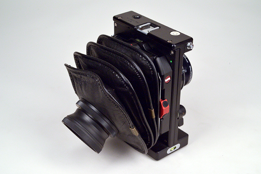

The Italians have an answer, made of fine leather, a good loupe and a rubber eyepiece, perfect under the Mediterranean sun:

Now all you need are some Polka dancers to go along with that accordion.
The alternative are slavish squires to hold the black drag fluttering in the wind...
Oh, and the Italians don't dance the polka but the Tarantella, which is more 'provocative'...
