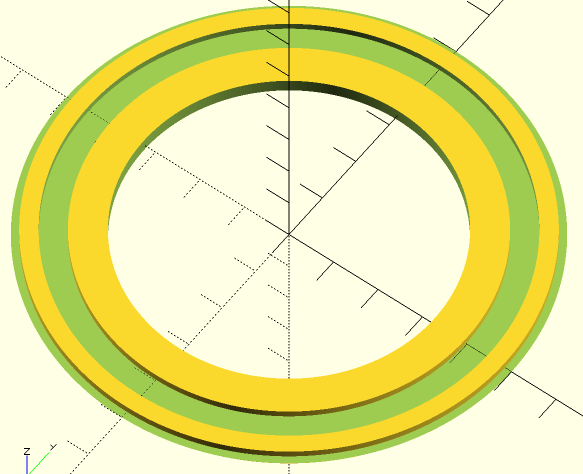

My model is based on measuring an existing lens board, but I'll need to do some runs to make sure the light traps are the correct size. I modeled the lens board using OpenSCAD which was designed perfectly for me, since you just code the model using primitives and boolean interactions:
I haven't added the lens mount hole, but its in my code, when I get ready to do the final prints, I just uncomment a single line to give me Compur 00, 0, 1, 3. And adding custom sizes for odd mounts is easy, its just adding a single line of code with the diameter of the hole in the model definition.

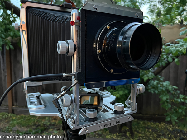

I print 3-D lensboards all the time. I just use standard black PLA. I have no light blocking issues ever. Here's a custom board for front mounting a barrel lens on a Sinar Copal shutter. Some people would say that this is not a proper use of the Sinar shutter, but it works great for me.

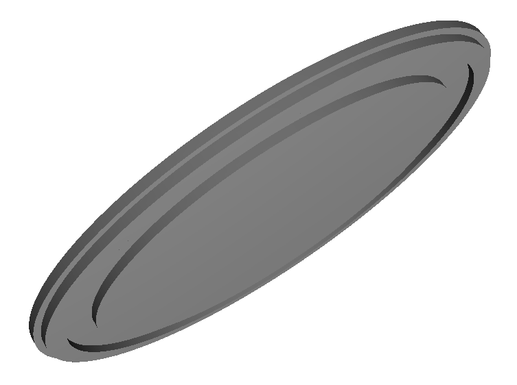

If you'd like version of the STL with less common hole sizes for ilex, compound, supermatic, and all the lesser known shutters, let me know the size of the hole you need (diameter) in milimeters and I'll create a model. Just a note though, the 65mm copal hole is close the largest hole I'd be comfortable using on one of these lens boards, and the 65mm hole version looks like this so there isn't much room for a larger hole.

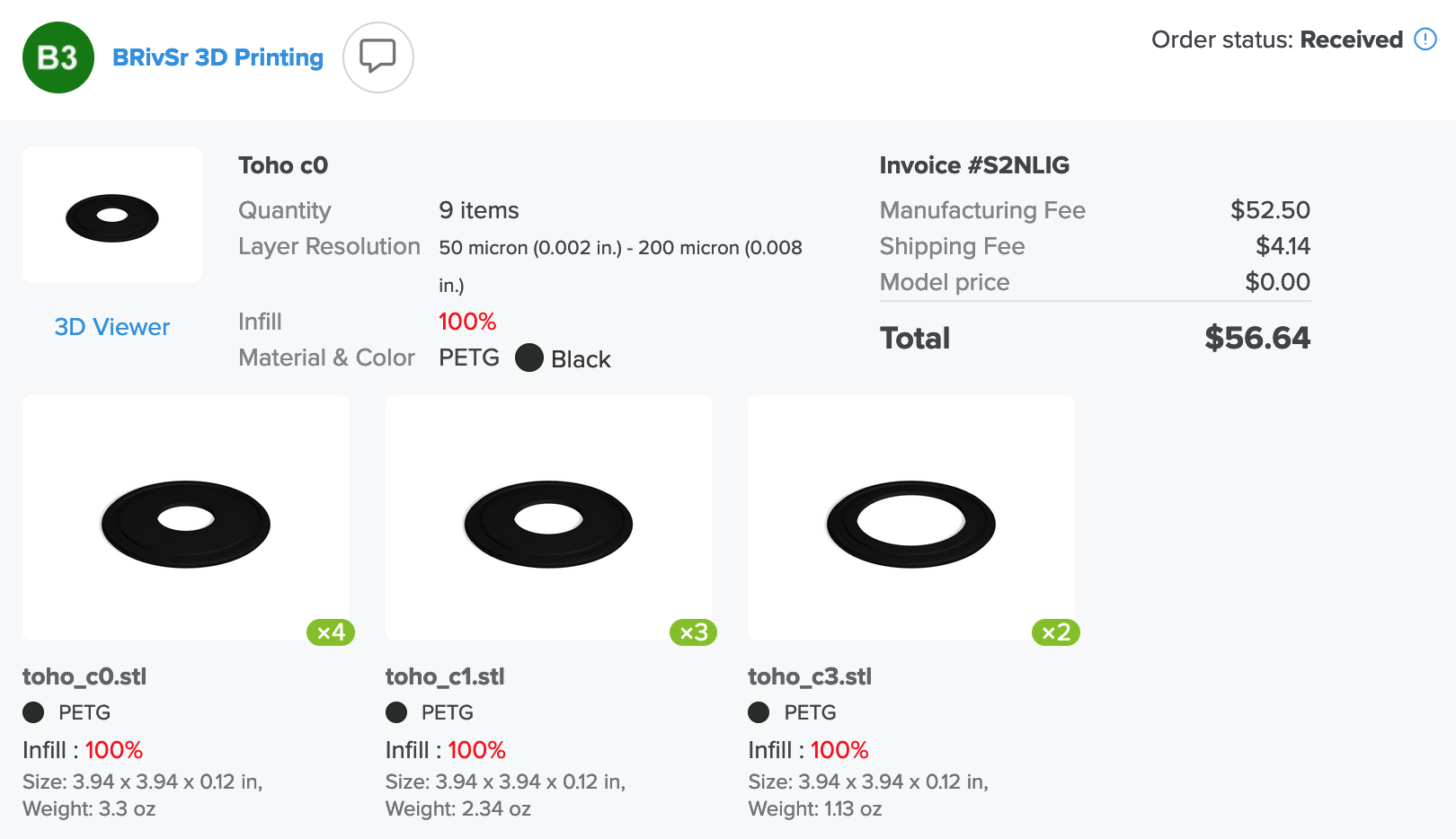

There are a lot of places to print, but I used treatstock.com. The don't do the printing, but are basically a frontend for a lot of different printers. I uploaded my file, specified a quantity, a material (PETG in my case), a color (black, obviously), and a infill percentage (100%), and listed all the printers that could do what I want, and a price for each. I selected a printer, and completed the payment on Treatstock. They were printed pretty quickly and mailed to me. The printer was in Phoenix and I'm one state over in New Mexico, so they got here pretty quickly.
The first thing I sent was a rough draft of the board for two reasons--one to test fit, and two because I didn't know if my choices in material or design were appropriate. For very complex 3D models, I'm sure there can be issues due to how the object is built in layers. imagine a dagly thing (no not that) being printed. If its only connection to the rest of the object is above the object, it probably would have issues due to being printed in layers. Thats why I did a test print first before ordering a bunch. I had no experience and was willing to sink $15 to see if it would work for me.
Here is what I paid for 9 boards (4x #0, 3x #1, 2x #3)
