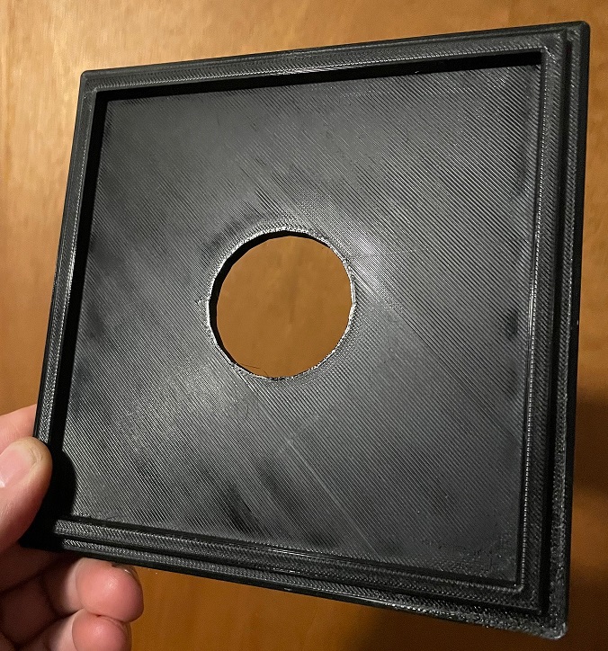

First try at printing a lens board and I almost got it right, but not quite.
I thought I had rounded the corners, but the radius somehow didn't make it into the file and I had one corner cool too quick and lift off the print bed.
Using PETG, so I'll try again once I get the model restyled and put down some glue stick to see if that will help with the lifting.
Takes 13 hours to print each one, so it's not a fast thing on my printer!
New to Tinkercad, new to printing with PETG and new to 3D printing in general. There's a lot to learn...

Using PETG
Yeah, that's always a little more challenging than PLA. PETG also has the disadvantage of being hygroscopic, so if you leave the filament on the printer exposed to air, it'll start to give issues in no-time. I've gone back to PLA for virtually all of my printing.
Try raising the bed temperature and use an adhesion spray; this can help in reducing the curl/lift problem. But PETG is liable to this anyway.

Looks like a Sinar board, so reasonably thick. Three base layers and three top layers, three walls, and 20-25% zig-zag infill. 50mm/sec maximum. I'd probably use some flat black acrylic paint on the inner surfaces to reduce secondary reflections and add a bit of extra density just on general principles.
I do not have a Sinar board on file, but my Galvin to Wista adapter at those settings is under 3 hours. It sounds like you are doing more infill than necessary?
I tend to use a lot of Sunlu's PLA+, and only move to something else if there is a good reason to do so - flexibility, stiffness, tensile strength. So much depends on layer adhesion and how the layers run in the object compared to the stresses when it comes to choosing the material.
It was supposed to be a 6x6 Calumet C1 (or Deardorf), 8x10 lens board with a Copal 1 hole.

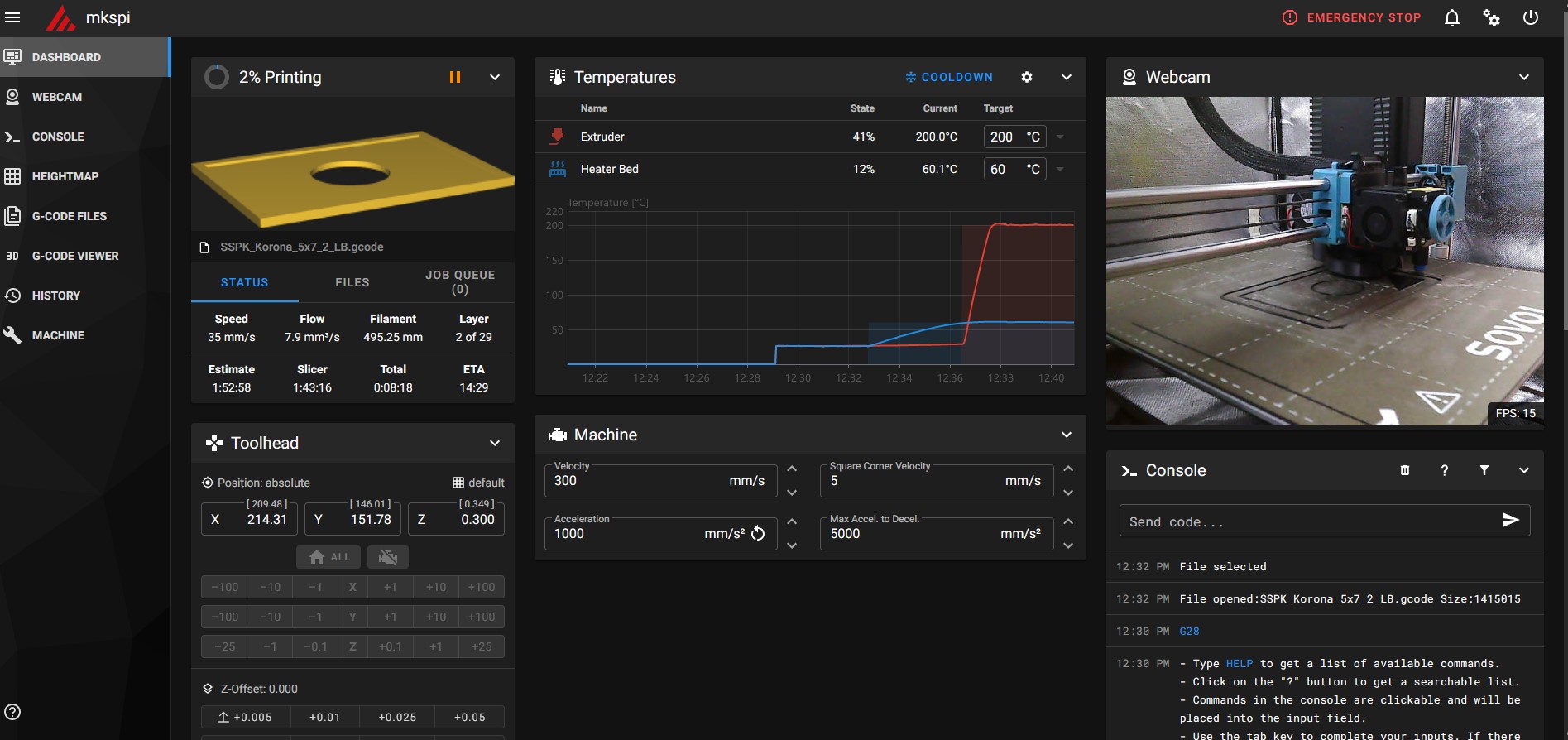

I am using Sunlu PETG with default settings on a Sovol SV06+ and slicing on Cura and only a 10% cubic infill with a 4.0 nozzle.
Going through various tutorials to try to speed this printer up, but I am a rank amateur and it's going to take a while to get up to speed, so to speak.
Ordered the Klipper upgrade kit yesterday; maybe that will help.

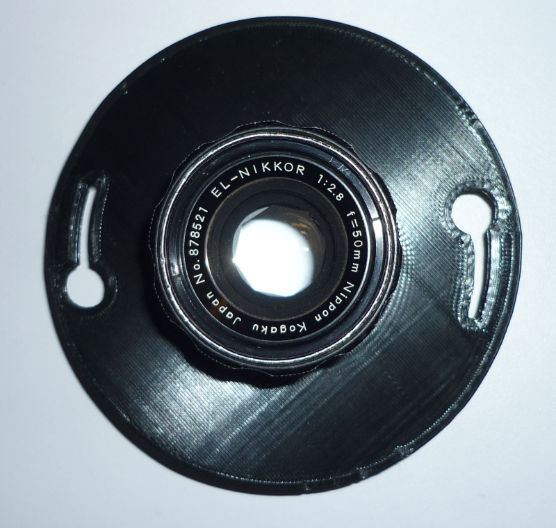

Thanks for this
I went with 5layers top/bottom and black PLA+ it seems light proof.

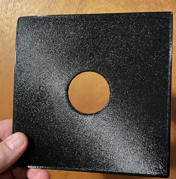

After a wild toboggan ride down the 3D rabbit hole, I am finally getting decent output in a reasonable amount of time.
Word of advice; if you just need a few parts, lens boards, tank caps, etc., just spend the money and buy them outright. I guarantee you will spend far more than what it is worth trying to make it yourself 3D printing.
However, if you want to continue to prototype and design new gear, be ready to invest time, money and brainpower in an ongoing fashion.
I really don't regret it, but let me tell you, it is certainly NOT "plug and play" as the manufacturers suggest unless you just want to print endless copies of a "benchy".
