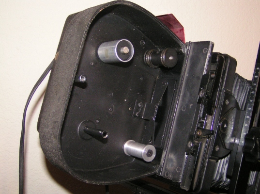

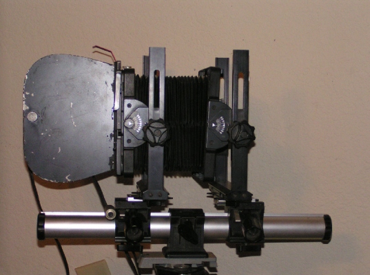

I bought this off ebay a few years ago. I couldn't give you a good reason why. I think it was for a long roll portrait camera using 35 mm perfed film. I played with it a bit and it works. It has an electric motor that moves the film forward onto a take up reel one frame for each push of the hand held push button. It locked onto the back of my Omega E without difficulty.
I sacrificed one 36 exposure roll to see how to work and load it and loaded another in the darkroom. I shot a few shots with it but as I recall the second roll is still in it. :rolleyes:
