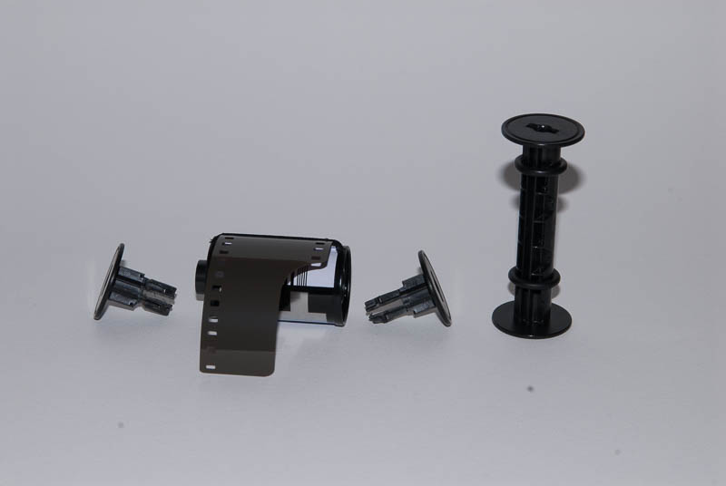

    Has anyone tried the plastic 35mm to 120 spool adapters? I see that Japan Camera Hunter website has them. Also some on eBay. Wondering how well they work, how you attach to takeup spool side and how you rewind the 35mm after exposing. Looking at trying in my ETRSi.

    I made my own by hacking away at a 120 spool. I'm sure the 3D printed ones would be better.

    Yes, and Bronica has film backs that take 35mm in medium format backs. But these adapters look to be basically cylindrical plastic pieces that are the diameter of a roll of 120. One snaps onto each end of a 35mm roll of film. The 3 pieces snapped together end up being the exact dimensions of a roll of 120, with the 120 "keyhole" ends. Presumably the full thing snaps in where a roll would normally go - and I guess you pull the film out, around the back - and then put the 35mm leader into the centre of a 120 take up spool. I guess if you get the alignment right, it must track squarely for exposure. I'm thinking upyou then guesstimate the position in the viewfinder and, when roll is done, either open back in darkness and put film directly onto a developing reel - or somehow roll it back into the 35mm cassette in the dark?
  6. I would need two devices, one for each end of the roll and then either advance it into another cassette or rewind it in the dark.

    Years(!!) ago I built my own from 120 spools to run 35mm Kodachrome through a Pentax 6x7 - like as a cheap xpan. I only built one set, ran the film into another cassette (so you could change film it in day light), and rewound back afterwards in a dark bag to send it off for processing.

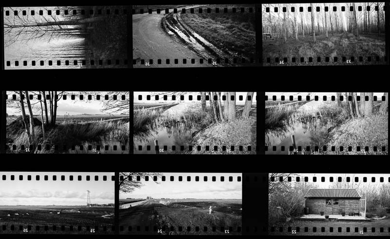

    It's a lot of fun. You can have 135mm pano with sprocket holes. Sadly, the Hasselblad is not so great because it's vertical pano unless you turn the camera sideway, which means using a prism instead of WLF...

    An old friend has converted (with much effort and even a little blood) a 616 folding camera into a nifty 35mm shooter. Like others, he enjoys the visible sprocket holes as part of his images. Everything he has shot with this home made gadget has been mostly out of focus except for the infinity shots, and otherwise quite terrible, but we haven't the heart to tell him, he is so proud of those images and his efforts.

    easy peasy :smile: Home made & suitable for every 120 spool and all camera's.

    in the same time you're horsing around with the link I cut two old 120 spools AND for free :smile:

    By employing such adapter on a plain MF camera one can yield much higher aspect ratio than with a plain 35mm camera.
