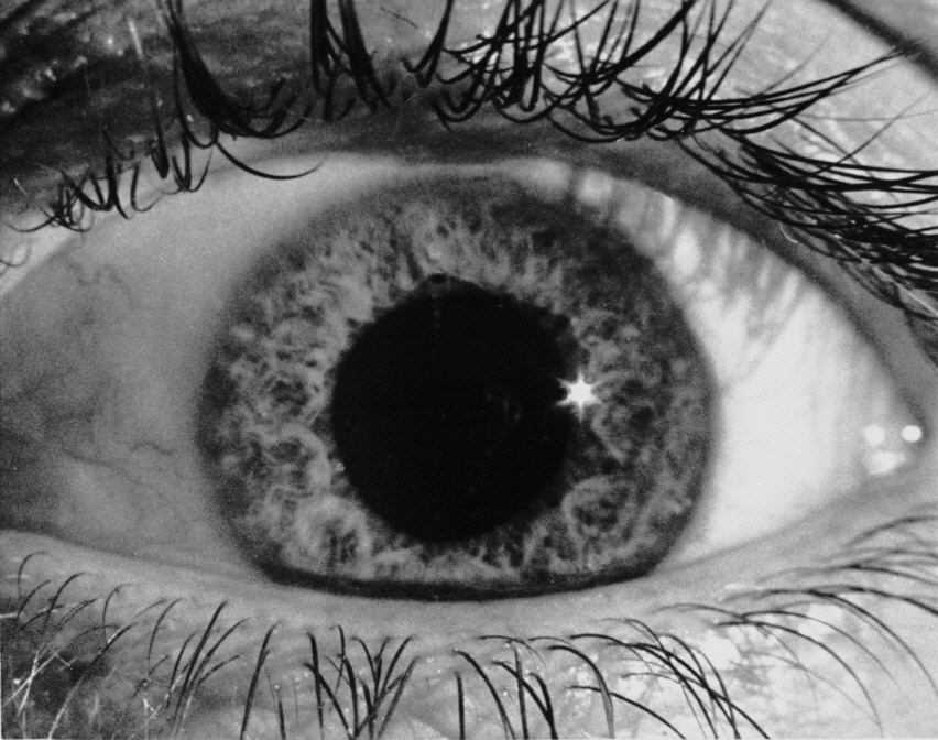

Dear Wayne;
you might consider Microdol X if you want the smoothest grain from a very big enlargement. Here is a crop from a full size enlargement to 24X30 from a Panatomic X 35mm neg. I shot in 1964. I don't know how much larger the grain is in TMY2 but you can see how smooth the grain is in this enlargement.

Perceptol is still available and a good alternative to Microdol-X which has been discontinued although there may still be stock in some stores etc.
However I'm another who would recommend Xtol with Tmax 400.
