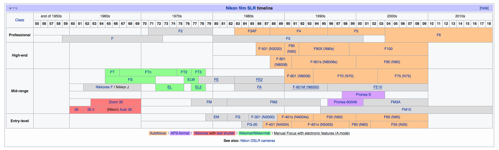

I believe Nikon put the most advanced matrix metering in the later cameras, so according to this diagram, the F100, F80, F75 and F6 would be the best. Since you already have the F100, you probably can't get much better than that in the Nikon system.
