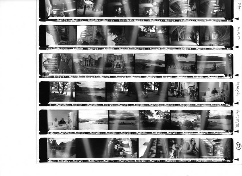

  16. Leigh Youdale
    Leigh Youdale Member
    Messages:
    232
    Joined:
    Oct 9, 2007
    Location:
    Sydney, Aust
    Shooter:
    Bump!
    I know this is a hoary old chestnut in terms of content but I thought rather than waffle on I'd let folks see what a severely zapped film looks like.
    The film is Delta 400 and was compulsorily placed in checked baggage when leaving Heathrow in 2006 due to a security scare at the time (the Shoe Bomber, if I recall correctly).
    This is the proof sheet.

  21. Brian Legge
    Brian Legge Member

    Leigh... that's the BEST example of CT damaged film I think I've ever seen!

    Location:
    Sydney, Aust
    Shooter:
    Well, I wish I'd never seen it. Main shots were of Fountains Abbey in Yorkshire, and it's a long way from here to go back for a re-shoot!
