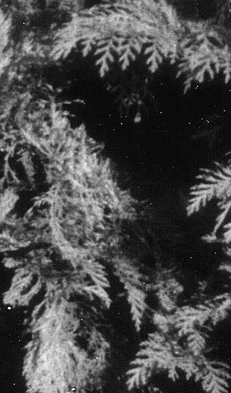

file attached. This is an original sized (tiny 1cm x 1.7cm) section from a 40" enlargement. I printed a section to 10x8 RC and scanned, cropped this portion, applying average unsharp mask to get over the softening of the scan. Because of the low resolution of the screen, you'll have to enlarge it a fair amount to see the detail, but you'll get the idea of how much detail this lens puts down. Plenty enough for very close inspection of a 40" print.
Original aperture of F32. Movements were applied and depth of field was required for this section to be totally sharp. I chose it as the nature of the subject made assessment easy. So this is very much real world stuff....representing teh reality of what I will get back fro the field.
Not a perfect test by any means, but enough to show that this lens leaves nothing to be desired in terms of real world resolution. A section from a 20x24" simply has more info than the eye can resolve without a loupe.
