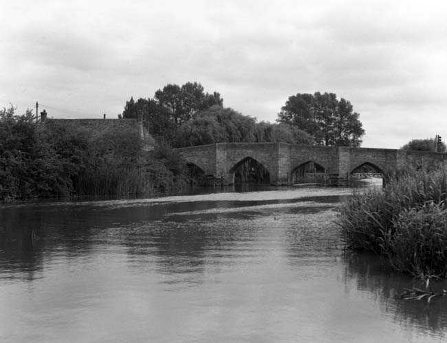

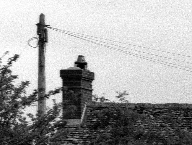

I took the lens off mine at the weekend and mounted it on a lens panel for my Shen Hao... Took it for trip to the upper reaches of the Thames at New Bridge - interesting name for a bridge built over 700 years ago (and still sitting on its original Elm foundations)...
Very disappointing: the lens is far too good! Below are two scans of the FP4+ neg (ID-11 1+1) taken at f/11 - a full 4x5 scan and a closeup of an edge detail. Usual excuses apply for the scan quality (in this case somewhat justified as the closeup is scanned at 3200 ppi for which the Epson 3200 photo scanner really does not have a good enough lens). A bit of sharpening applied to compensate for the mushy scanner lens.
Given that the telephone wires are at at the edge of the 4x5" negative, and are sharp as a razor on the neg, that's not at all bad for the lens (complete with fungus). You can easily count the slates on the roof of The Rose Revived pub.
Cheers, Bob.

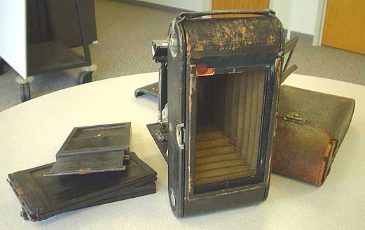

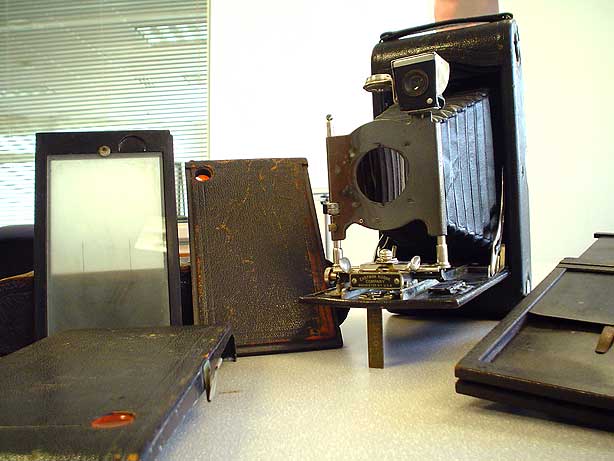

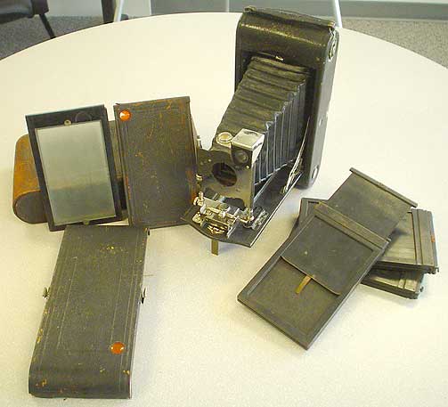

Here's some pics of a 3a I just sent to Jeremy...
