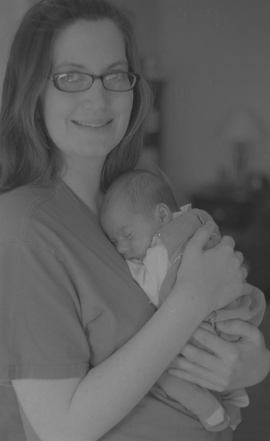

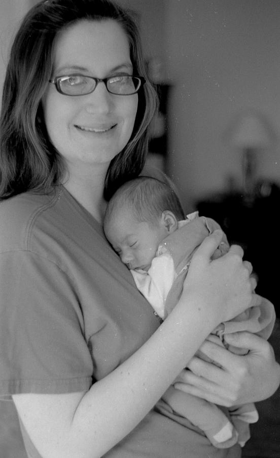

Results
The results seem to lack contrast when a no-edit, no-auto scan is made on my Epson V500.
I developed with D-76 stock at 70F. The timer was for 6:15 per instructions and I agitated every 30 seconds. I started the timer right before I began pouring in the developer, which took a few seconds. I started pouring it out after the timer finished. Was this too short?
Do I need to slightly lengthen development or is the low contrast a product of scanning (I don't the negative doesn't looks that bad)?

DLawson
Jun 17, 2009
320
Dayton, Ohio
Was your lens cap removed for frames 6-12?
Equivalently, are you sure you shot the frames?
This weekend, I developed a roll of film that I'd shot testing a "new" camera. The last 4 frames (of a 35mm) were clear. I scratched my head about that for a couple days, coming up with several theories. But in the end I realized that I couldn't think of anything I'd shot after the last frame that had an image. I'd had a problem with the film (torn sprocket holes) that required opening the camera, and I think I messed up the frame counter when I did that.
BTW, whenever possible, don't test out an unfamiliar camera with an unfamiliar film. I have a roll with very low contrast, and no leading explanation.
