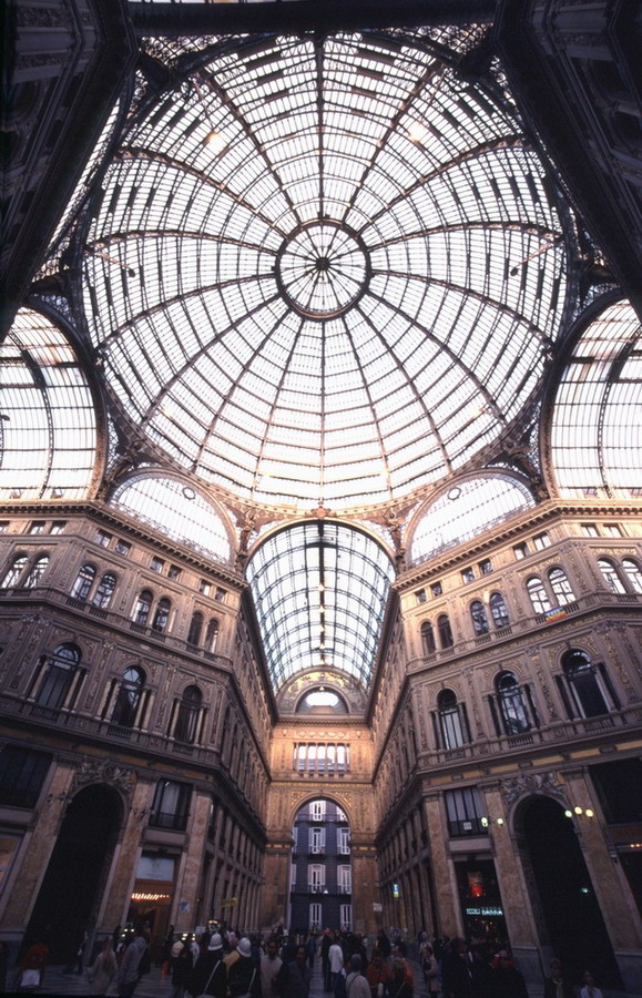

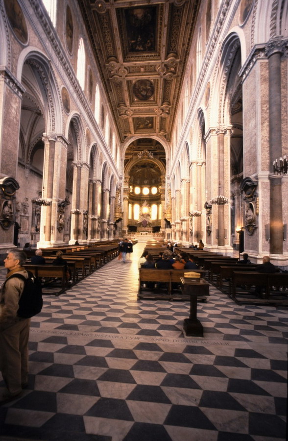

OK lens? No. Stunning!
Not just an OK lens. It is stunning. Kinda difficult maybe but stunning.
If you want verticals to be vertical you need a level. I glued the tiniest one available (12mm diameter) to the finder so that a vertical shot is vertical.
The center portion of the frame is practically free of distortion. At least it is very manageable. The outer parts are stretched a lot. Naturally, because without barrel distortion you get Mercatorian (?) distortion. Like in stretched maps of the world.
And there is vignetting. Not necessarily a bad thing, you can use it. It is gone by f5,6 or f8.
Did I mention sharp? Well, very.
cheers, Rob.
The method of restricting photo attachments is very unclear. It has taken me three edits to get it right. This takes away the joy of posting on APUG.
cheers and goodbye. May light and wisdom be with you all.
