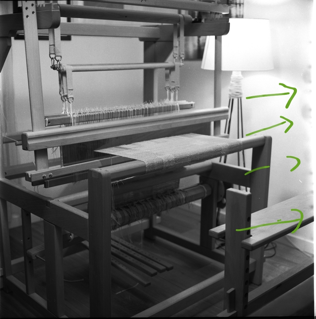

I've been having a problem while developing 120 film for about 8 months now and I can't seem to solve it. Every single roll of 120 that I have developed in the past 8 months has had dark edges which look like light leaks in random spots outside of the frame extending to the edge of the film. Sometimes they bleed into the frame. I have had this issue with a Hasselblad 500C, Mamiya RZ67, Mamiya RB67 Pro-S, Mamiya 645, Mamiya 645 Super, and a Kiev 60. I had been developing my own film for about 2 years prior to this incident starting and had never had this problem before. I use paterson tanks with 600ml of chemistry in them, and I have not changed anything in my processing. Could it be possible that all of these cameras have the same light leaks which are not extending into the frame? Or is it likely an issue of too little chemistry in the tank? Or maybe the film is sticking to the reels and developer is unable to get into this area? I haven't bought new reels or anything like that, I have removed the ball bearings from all of my Paterson reels to ease loading but I don't see how that could be causing the problem. Any ideas? Also if needed I can post photos of the negatives to help diagnose. The worst ones are from the RB67, it has a Pro-SD back on it so the only light seals are the dark slide slot. Though these definitely don't look like they're dark slide light leaks. I've put about 100 rolls of film through this RB67 and never had a problem, it's been sitting unused for the past 13 months and I don't see what could possibly have changed. I'm going out in a bit to shoot a test roll and use more chemistry in the tank this time, maybe my reels are getting worn and are floating around during agitation?
Dark edges indicate light leaks, not undeveloped areas. Rather than the cameras,I suspect your loading/unloading techniques. Somewhere along the line you appear to be allowing the backing to get loose on the spool. Regardless of experience, we all get a little lax at times.
The seal between the backing paper and the edges of the spool are not perfectly light tight. Always load and unload film away from direct light and immediately place exposed spools in aluminum foil or use a 120 can. These are available from photo supply stores. Also check the paper after exposure if the spool wobbles in the camera the edge of the paper can be damaged.

What you describe is not camera specific. Is it one edge or two edges. One edge can be light leak, chemistry or dirt in the reels. Two edges sound like the exposed roll was not wound tightly enough or the film was loaded and unloaded on bright light. Do not over tighten an exposed roll and do not put a tight rubber band around the roll or you will have a new set of problems.
Normally it's only a minor problem and I simply ignore it, yesterday was the first time that I had it extend into the frame. I just hung the roll I shot today up to dry it and it's just fine. I made sure to wrap the backing paper fairly tight but not overly tight when I sealed it, and that appears to have solved my problem. Apparently I was just getting lax with my film handling.

I replied on the previous page and said that I found out it was my lax handling technique. I still get a teen weeny bit of fogging on the edge before the first frame, but thats no big deal. When I started shooting again 8 months ago after a 6 month break I must have just been slightly clumsy in my film handling.
for what it's worth I have been getting exposure in the rebate area on Tri-X since they changed the backing paper - rolls are fatter, ie not winding as tightly. at first I thought it might be my camera but I put a roll of Acros through and it was very tightly wound.

Hi,
I'm new here (greatest film photography forum I know), so thanks in advance for all your threads about this issue.
I'm not able to see your original image (I don't know why), so I've upload mine, because I've the same problem with my Rolleiflex films too!
I'm careful to charge and discharge films at low light ( always discharge in my changing tent at total black light), so I think could be a problem with my Paterson movements... Today I'll shot and develop a roll follow your threads advice:

Hi, so do you think the problem could be the type of film itself?
I notice some kind of films, like Rollei films, are more sensible at lights (they are Pet films). My problem was with Hp5, Delta 100 and Fuji Acros too... but today I'm doing another roll of hp5 new with care about all your devices and I'll post it. Thanks.
looks like a "fat roll" to me. I imagine fat rolls happen more easily if there is little resistance on the side the film roll is dropped into. If your camera has a flat spring that pushes against the roll of film, gently bending that to provide more pressure is worth a try.

Now I've finisced a roll, I'll discharged it and check the inside cover of my Rolleiflex plate, this should be the problem!

I was saying that even with the most sensitive film it isn’t really an issue unless loading/unloading in bright light. The fogging I’ve experienced has only effected the rebate area and hasn’t intruded into the image.
I think it’s mostly about how much tension is on the spools as others have said.
