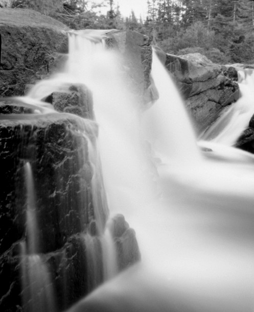

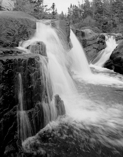

Photos: 110mm SSXL versus 0.45mm Pinhole
Here are two photographs that were requested for visual comparison:
the first is taken with a 110mm Super Symmar XL
the second is taken with a 0.45mm Pinhole
Other than swapping lensboards no adjustments were made to camera or its position, except for exposure time.
As previously discussed the pinhole is not at the nodal point of the lens so there is a slight difference in maginification.

I can see why this could be a problem for you, I like the composition in the lens image better than the pinhole image.
