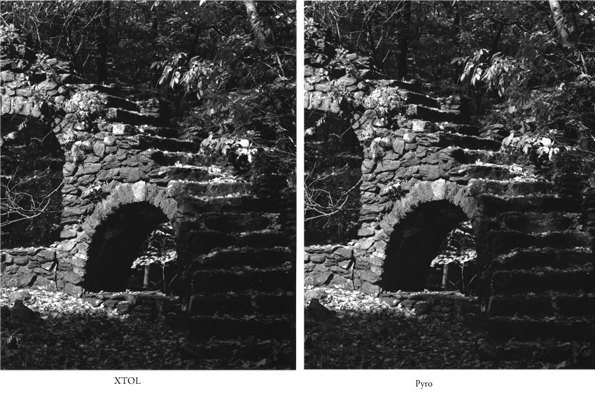

I am in the process of trying out a pyro developer. I made a set of negatives to compare using the same subject (Madam Sherri's castle).
I'm not doing the exercise in search of a magic bullet, but it seems a good illustration that magic bullets are not real.
Chesterfield, NH
Calumet view
unrecorded
FP4, Xtol 1:1, pyrocat HD 1:1:100
Ilford MG IV
Xtol #2, Pyro 1 1/2 with a color head
Of course there is a magic bullet. It's familiarity and skill with your chosen materials. =)
I've rolled through a few film/dev combination and they all had one thing in common. The more I worked with them the better my results. I'm finally sticking to one now. Smartest thing I've done in some time, I think.
I like your experiment! I've also found this to be true in my experimenting with developers. But sharpness is one thing that can be controlled through development. I am an Xtol guy, but the more and more I play around with Rodinal I've starting to really like the sharpness I'm getting from that developer. Thanks for sharing!
For non semi-stand development I prefer Xtol. But since I mainly do semi-stand development my soup of choice is PyroCat. But then again I haven't worked up any tables for semi-stand in Xtol. Ummmm.
No Magic, just hard work and for those that give it all, get great results. I usually don't change but when I stumble across something that someone is doing and it could help me I give it a try. I use Pryrocat for sheets and Microdol-x for roll.I go back and forth from ansco 130 to amidol. I have two enlargers but right now I'm doing Pl/Pt with my sheet file and digital negs with my small film to make pl/pt. I have found no magic bullet to make my prints better. If pyro was a small grain developer I would use it with all negs but it isn't so I have two. Ansco to Amidol-Amidol to Ansco. my prints snap with both. I guess making enlargements I use the Ansco more due to cost and quanitity.

PS. scanning pyro is harder for APUG. :D
Good technique, good film, the developer doesn't make all that much difference. I have pretty much settled on Rodinal and Pyrocat HD, because both are VERY economical in their high dilutions. Rodinal gives great sharpness with slow speed films ( I use Pan-F) and I like that you can get the same contrast with slight under-development in Pyrocat.
