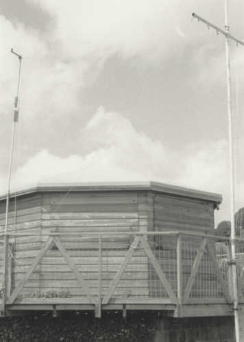

Following the thread on Ilford Multigrade and selenium toning, this is one of a series of photos demonstrating mild bleaching, and bleach redevelopment prior to toning.
As for the straight print, but then bleached to completion with a ferri bleach containing NaCl, redeveloped using soft Beer's, and toned with selenium (as for the straight selenium toned print).
Pentewan, Cornwall
Bronica ETRS, 50mm
Delta 3200, DD-X
Ilford Multigrade, Ilford Multigrade
