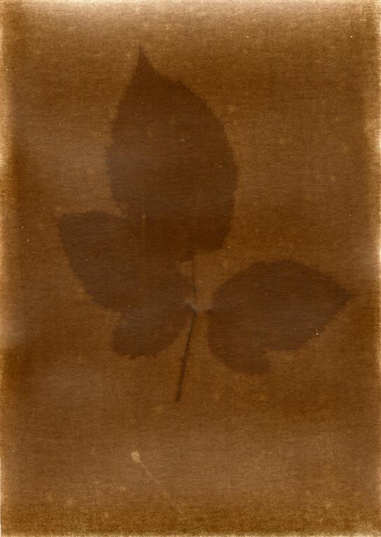

Lumen Reversed experiment
willrea
Lumen print reverse processed. The developing/fogging solution produces the brown tones.
Forte Polywarmtone
Hi there, I left a comment about a lumen print where a developer was mentioned. I queried this, as it was the first time I heard about actually developing a lumen print. Until now I only knew of exposing and fixing.
I cannot find my comment and a possible answer. I am interested to try this process myself.
Regards, Thomas
Well, normally if you develop a lumen print, it'll turn black. Since I bleached it out when it goes through the fogging developer it'll develop properly and be a postive image, not a negative one.
If you dont use a fogging developer you'll have to expose it to light then use a developer that'll give you the results you're looking for.
very nice Will! Thanks for sharing! I'll have to try this one day
willrea wrote about bleaching and fogging developer. Sorry, I am a beginner in special processes. Do you have formulas for those?
Regards, Thomas
