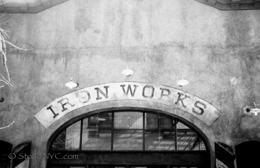

Just playing around with some old shaws film and processing it in B&W ... it's fun and frustrating, I wouldn't try this if you're wet printing but with a scanner you can get some good results if you expose properly. I have only done this with old film, so I don't have as much experience with new, I only do this with film I would otherwise throw away.
Seems to work best with 200 speed film rated at 50 ... I tried 400 speed rated at 100 and at 50 and it just didn't have the same consistency or look, not sure why.
New York City, USA
Zeis Ikon Contina Matic II, Sekonic 7xxDR spot meter
1/30th @ f/8
Shaws 200asa
EpsonScan - little to no exposure adjustment just cropped the scanner edge lines
oolalajp said:
interesting results. what developer are you using? if i understand you correctly, you just use a standard b/w developer to develop color film. is that correct? sorry for all the questions!
Don't be sorry, questions is how we learn, I use Rodinal (Adox Adonal) I use it as a concentration of 1:100 and stand it for 1 hour, I agitate the first minute, then every 20 minutes. And I shoot the film two stops under so 200 would be 50ASA etc. it's not bad, grainy, but not bad.
