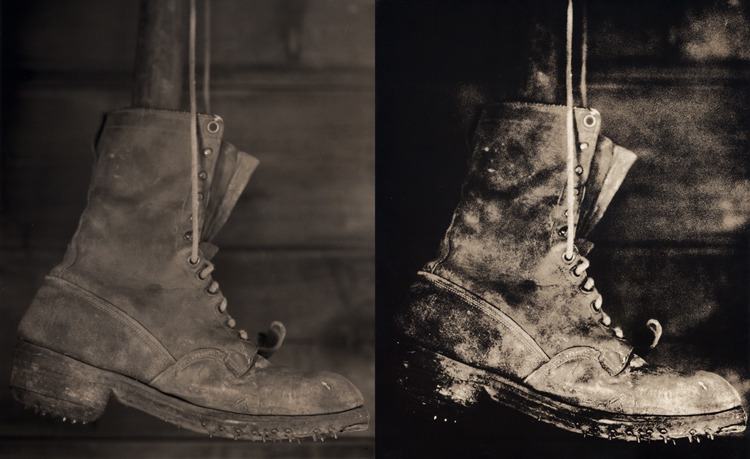

Spent a day playing with one negative and different papers, and bleach and redevelop. The first boot is on MGWT, dektol developed and thiocarbamide toned. It's mate is on MGWT, hot Moersch SE5, bleached and redeveloped in same. Before it was bleached it didn't look very different from the first print. It is my favorite from the day's work.

These liths are wonderful. My choice is also the one you chose as favourite. Lith is fun and changes the mood of an image so well.
Hve you tried Ilford WT in "normal" developer and then...bleach and redevelop in lith?
I have tried that a couple of times in the past, but not with results I was happy with. I'll have to re-try.
I also should do some side-by-side comparisons of Moersch SE5 and Maco (Rollei now I guess) lith developers. (I know there are others, but those are the ones I've got on hand.)
Very good work. Thank you for sharing your results!
I was curious about that because of the examples in Rudman's book.
I haven't tried it yet...
