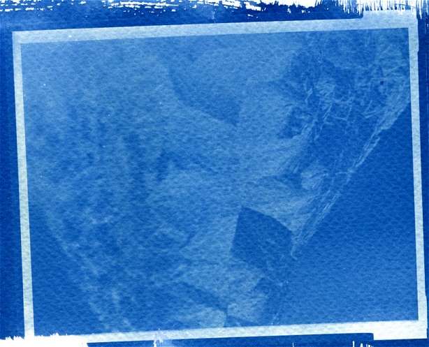

First enlarged negative. Original picture was taken with my Nikon FG and Vivitar Series 1 macro lens + extension, on Delta 100 film developed in Rodinal. Enlarged negative onto Fomapan100, developed in Diafine for the interpositive and developed in Rodinal for the actual negative step.
Cyanotype on fabriano watercolour paper, done under my facial tanner for about 4 minutes (little too long).

paper and chemicals
You don't understand how close the UV tube bank is; it's only about 2 inches away from the frame. The shadows had inversed - the highlights were left blue. The negative is a bit low contrast so I have to make certain allowances and forgivenesses.
