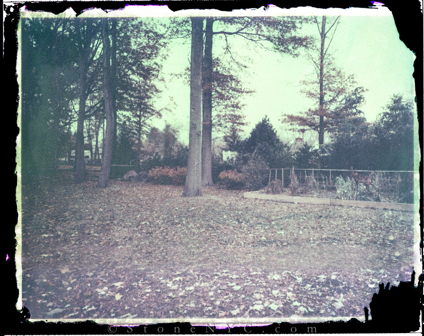

Basically I got a color negative from the Fuji pack film.
Trumbull, CT, USA
Toyo 45a, Rodenstock 75mm f/4.5 Grandagon-N, Sekonic 7xxDR light meter
f/16 @ 15 seconds
Fuji FP-100c NEGATIVE
Clorox Bleach, Epson Scan

Thanks, yea I think you would need a scanner, the pink hue is too dense I would think for normal printing, but I don't print optically (yet) so I could be wrong... the back side of the negative is just black, it's almost like rem-jet on kodachrome, the bleach just simply dissolves it, the negative already exists on the other side... you're just getting the coating off so that you can see through the plastic.
