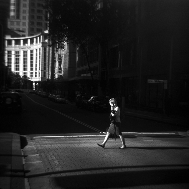

A couple of weeks ago I tried some Iford Pan F in my 1970s Diana. It was a bright sunny day in Sydney & working on the Sunny 16 principle I hoped to get decent results with the Diana aperture range of around f/11 to f/19. First roll was processed in Xtil 1:1 at the standard MDC time & was about 2 stops under exposed. I processed the remaining rolls with a 2 stop push. Xtol 1:2 for 15 minutes at 20.5 deg C. This was late afternoon, Philip St & Martin Place. I now operate on the assumption that the Diana shutter speed is 1/200.

say f/13 at 1/200
Ilford Pan F, 2 stops under exposed, Xtol 1:2 for 15 min
Agree with Tony, the slight blur actually adds something in this picture. Combined with the light, it really focuses you on the woman.
