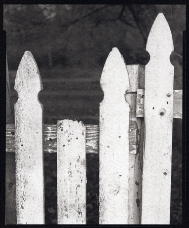

Broken Picket, Pt/Pd

One of my alt exchange prints. Previously posted as a lith print. These were the first images I made using Na2. It made a BIG differnce in my ability to get the print I wanted. I wish I'd started with that rather than the traditional method
Cedar
Crwon Graphic
f11, 1/25th
Rollei IR, Rollei High speed developer
Cot 320
I always say never reinvent the wheel if there is something that is working better do it. someone esle has already done the trial and error on it.
Love the photo, I'm not sure if it is the scan or the paper but a oxilic acid bath may give you smoother tones.
I had to with my cot-320
