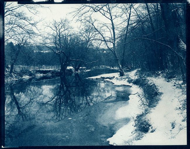

Cyanotype from 8x10 Plus-X negative
Antietam National Battlefield, Maryland
Deardorff 8x10 with 222mm Goerz Pantar Combination
N/R
Kodak 8x10 Plus-X/D-76 1:1
Cyanotype on Lenox 100
N/A
any clues as to how you got such a deep blue ?

I must say that this for me, is an acceptable blue as the cyanotype colour is not one that I relate to easily. Is this the traditional formula or the Mike Ware method ?
The secret to the deep blue is the paper. Lenox 100. I use the traditional cyanotype method and only single coat.

Very Very Nice - and true about color from using the right paper - I get blues like this with Cranes Plainotype as well. Another trick is to rince in H2O2 after the water development - it will finish the oxidation very fast.
